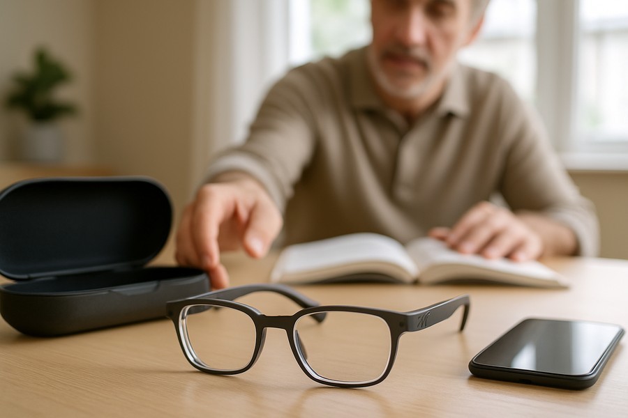

These glasses are a blend of cutting-edge technology and traditional eyewear design. They employ a cameraless eye tracking system in conjunction with liquid crystal lenses to automatically adjust focus based on the user’s visual needs. This means the lenses can shift between prescriptions, eliminating the need for separate lenses for near and farsightedness. Despite this advanced functionality, the frames maintain a lightweight and unassuming design, akin to any pair of regular glasses.
The eye tracking system uses a set of LEDs and photodiodes positioned around the lens. These LEDs emit invisible infrared light that bounces off the eyes and is then measured by the photodiodes. This system accurately captures the subtle movements of the eyes and how they converge when focusing on an object close by. Even minute details like blinking and the direction of the gaze are captured, all while consuming a mere 4 milliwatts of power.
Most of the tech components, such as memory, sensors, driving electronics, and the eye tracker, are cleverly integrated into the front frame of the glasses and the part of the arms closest to the hinge. The lightweight batteries used are similar to those found in wireless earbuds, giving an idea of the overall size and weight of the technology. A charging port is included in the glasses’ left arm hinge, and a single charge is touted to last a full day.
Design and Comfort
The prototype frames feel as light as any pair of conventional glasses. The team has diligently worked on refining the nose pieces and arms of the glasses to accommodate different face shapes. The lenses are made up of layers of liquid crystal and a transparent conductive layer of indium tin oxide. Despite the multiple layers, the lenses are incredibly thin and seamlessly switch into a prescription lens. Their thinness allows them to be integrated easily into lenses with existing prescriptions, and they can even provide correction for astigmatism.
