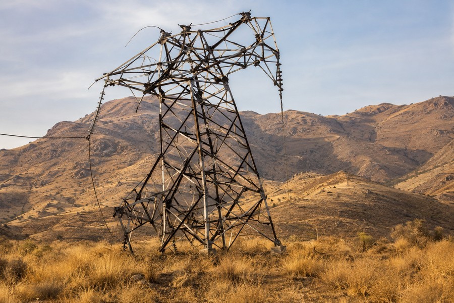

A devastating wildfire that swept through several mountain communities was caused by a broken, out-of-service electricity tower. The tower, which belongs to the area's main power company, ignited the dry brush below and started a fast-moving disaster. Fire investigators recently finished their official review of the incident, confirming exactly how the fire began.

According to the official investigation, the fire began with an electrical failure on a large transmission tower located near a local creek bed. Investigators reviewed video evidence from the area to reconstruct the exact moments the fire started. The footage showed a clear chain of events that happened in just a matter of seconds.
First, two bright electrical sparks, known as arcing events, occurred on the out-of-service tower in rapid succession. Immediately after these sparks, a piece of hot, burning material fell from the top of the tower. The burning debris landed directly in a patch of dry grass and brush underneath the structure. It took only 12 seconds for the dry plants to catch fire after the burning material landed on them.
Because the weather was dry and windy, the small fire grew incredibly fast. It quickly turned into a massive wall of flames that rushed up into the nearby mountains and spread toward several neighborhoods. The fire eventually spread across multiple cities, including Altadena, Pasadena, Sierra Madre, and La Cañada Flintridge. Emergency crews worked day and night to stop the flames, but it took 24 days of intense effort before the fire was completely contained.
