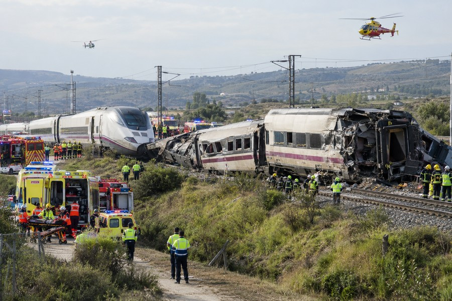

The crash took place between the towns of Mora and Orgaz, about 140 kilometers south of Madrid. It happened at 8:53 in the morning on a high-speed route that connects the capital with southern parts of the country.
A privately operated passenger train was stopped near the town of Urda when a state-operated train struck it from behind. The second train was traveling at high speed when it hit the stationary train.
The force of the crash caused several carriages to leave the track and fall down a slope beside the rail line. Emergency crews quickly arrived at the scene, while helicopters and fire teams helped with rescue efforts.
Rail service along the route was stopped. Trains traveling between Madrid, Ciudad Real and the southern region of Andalusia were suspended as investigators and rescue workers examined the area.
